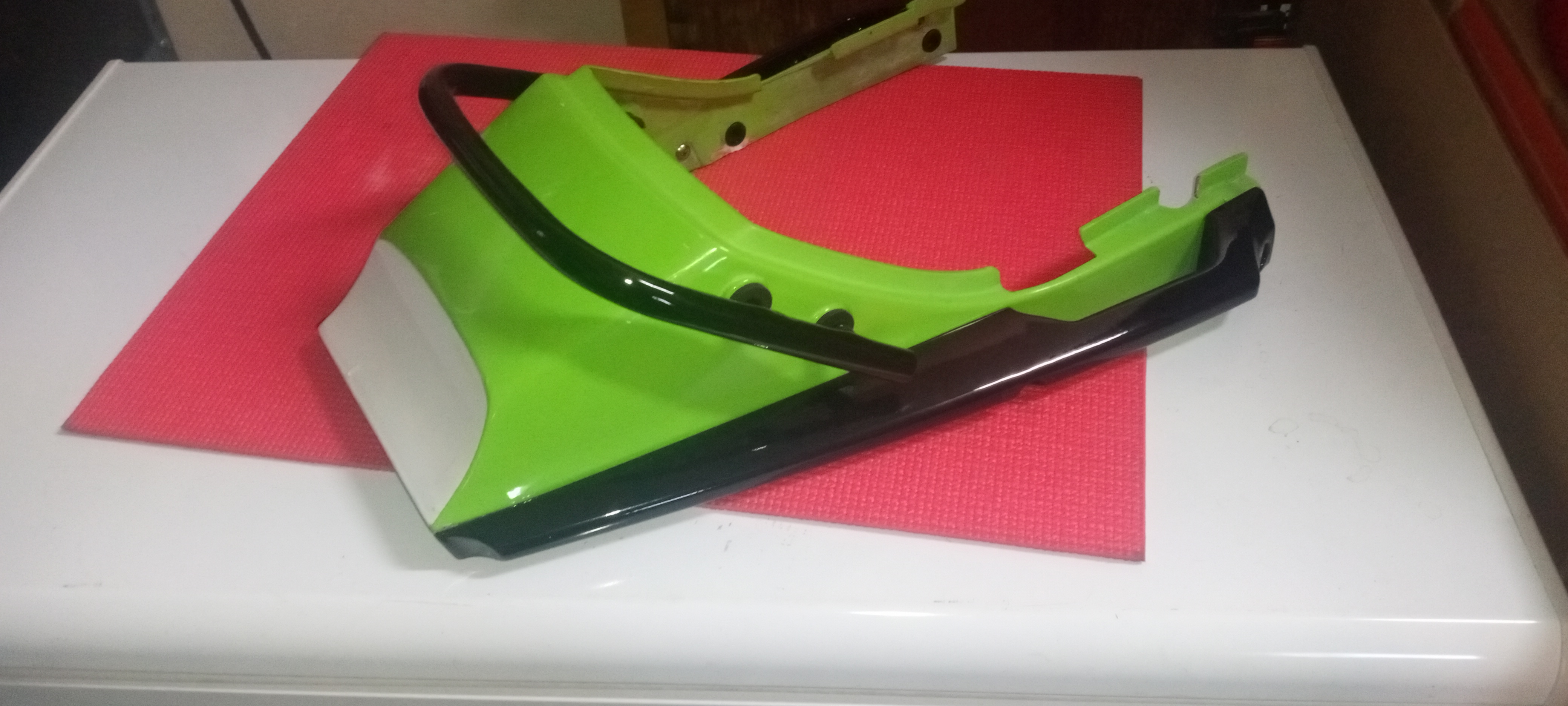

In other news.. Progress!!
Ok, I cheated a bit, the metal sleeves that fit inside the rubber grommets for the grab rail are sitting in the Evaporust right now, so it's not bolted on...
and there are still two small cracks to fix in the tail doodad.
and I need an M4 & M5 tap to chase some threads in various parts, including the strakes. (just ordered)

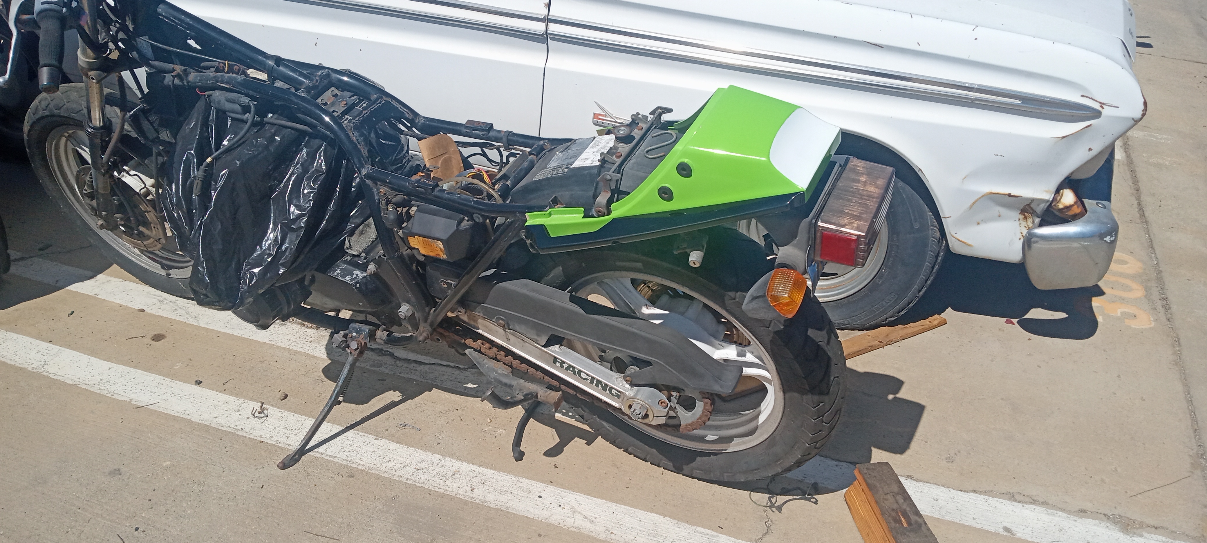

Today's plan was:
Fit exhaust
Fit carb manifolds
Change oil/filter
Fit carbs
Fit pods
Get it running...
What actually happened was:
Left my goddamn glasses at home
Put the tail on for a pic..
Put the tail back in the car
Dumped oil & filter
Moved bike under the swamp cooler
Installed the stud that came out with the nut when I took the exhaust off.
Installed ignition cover

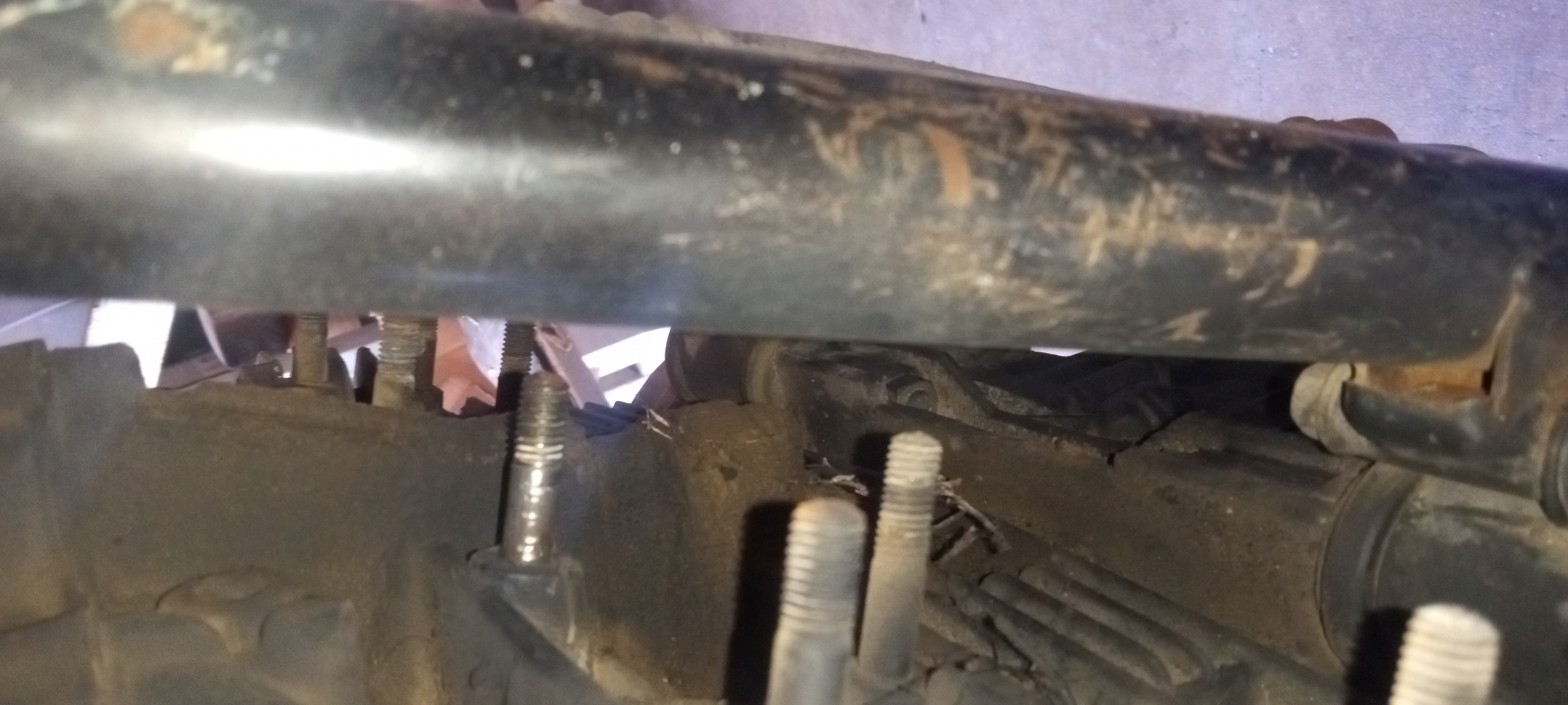

Discover the manifolds don't fit...The engine side is the right size, the carb side is the right size, but the fucking holes for the M6 Allens that bolt it to the head are too far apart...
Came home.
So now I need to drive out to APE in Rosamond next week & see if they have the right manifolds. Probably keep the wrong ones because they will fit other Kaw heads.

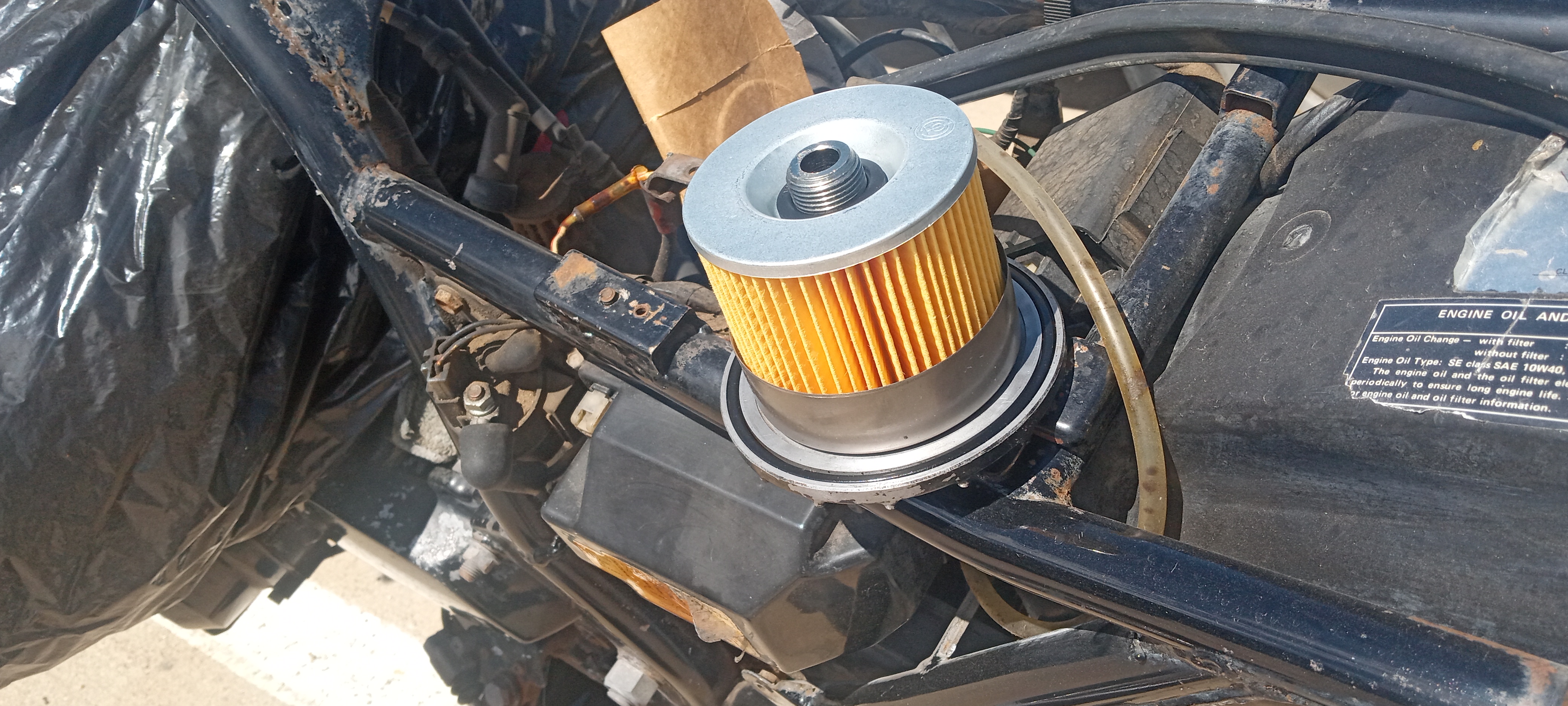

& Yes, the oil filter gubbins is assembled correctly.
Most Kaw's are: plate, spring, washer, filter, cup
These are: plate, cup, spring, washer, filter.
I have no idea why.
