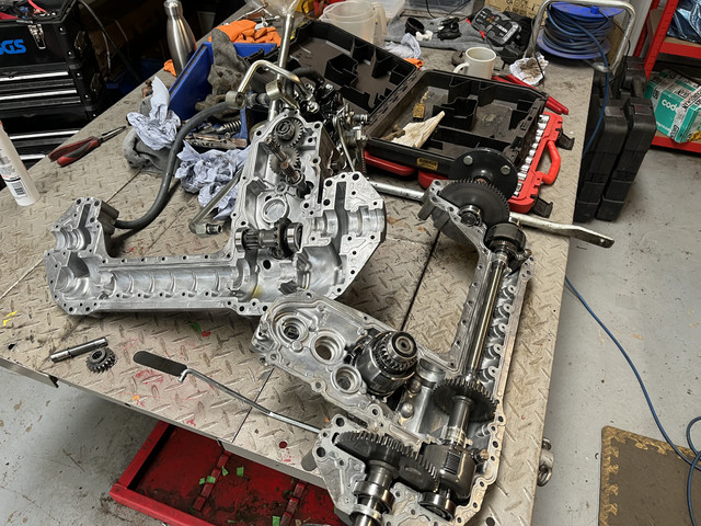

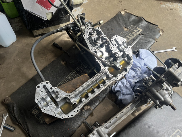

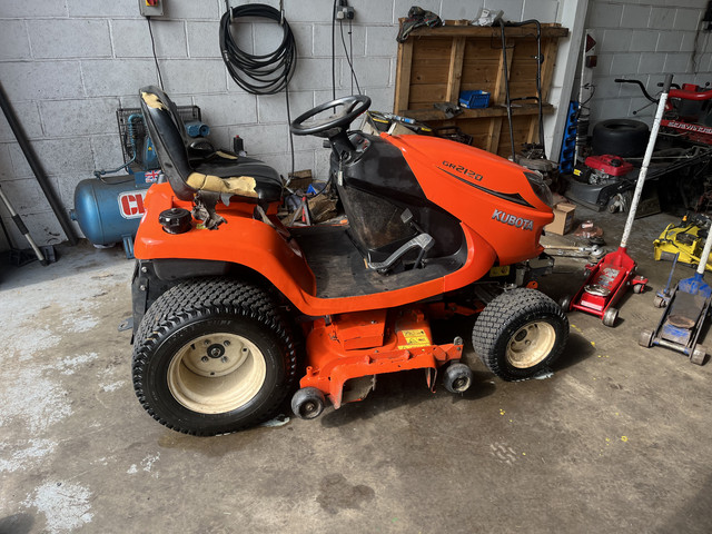

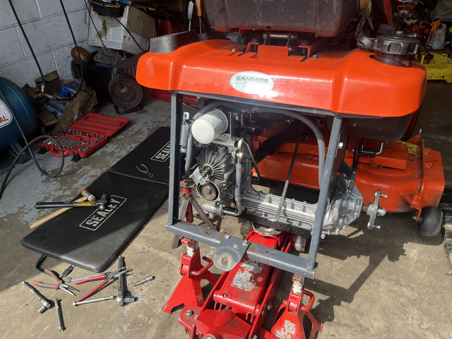

This one was a pain in the arse.
Kubota GR2120 in for a leaking transmission which was leaking from 3 separate output shaft seals, sadly only one of them you could without stripping the full transmission down so it was remove strip down replace seals + one bearing that had slight play then rebuild. Took a fair bit of time.

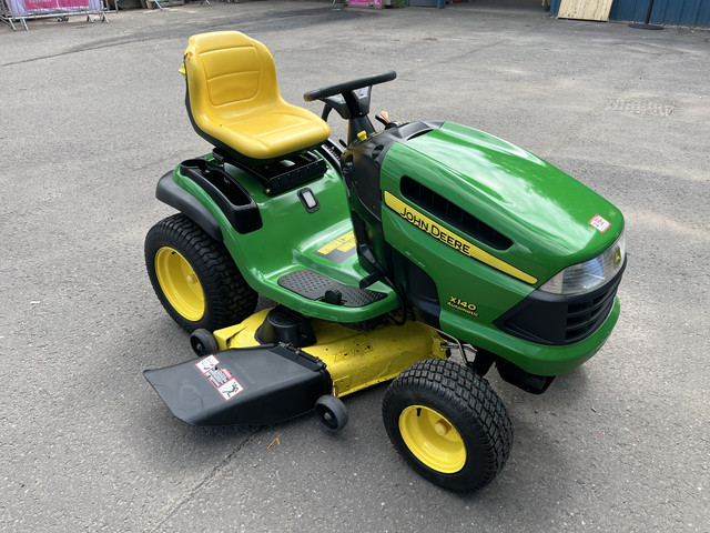

We get a lot of lawn tractors in for work, everyone seems to not bother during the winter months then all of a sudden can you do this and do it now. Typical, the majority of them require transmission belts then we’re having to wait for parts, all you get is “the grass is growing”
This one was my mates, pic before collection and the other two after it was ready to go. It got a full service, two new tyres, new transmission belt and deck belt. He had complained that there was no drive but that was because the bypass valve was open which they hadn’t realised, someone must have pulled the dump valve and left it like that. Touch up paint etc.
